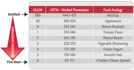

Consistency
Grease consistency depends on the type and amount of thickener used and the viscosity of its base oil. A grease's consistency is its resistance to deformation by an applied force. The measure of consistency is called penetration. Penetration depends on whether the consistency has been altered by handling or working. ASTM D 217 and D 1403 methods measure penetration of unworked and worked greases. To measure penetration, a cone of given weight is allowed to sink into a grease for five seconds at a standard temperature of 25°C (77°F).
The depth, in tenths of a millimeter, to which the cone sinks into the grease is the penetration. A penetration of 100 would represent a solid grease while a penetration of 450 would be semifluid. The NLGI has established consistency numbers or grade numbers, ranging from 000 to 6, corresponding to specified ranges of penetration numbers. Table 1 lists the NLGI grease classifications along with a description of the consistency of how it relates to common semifluids.
