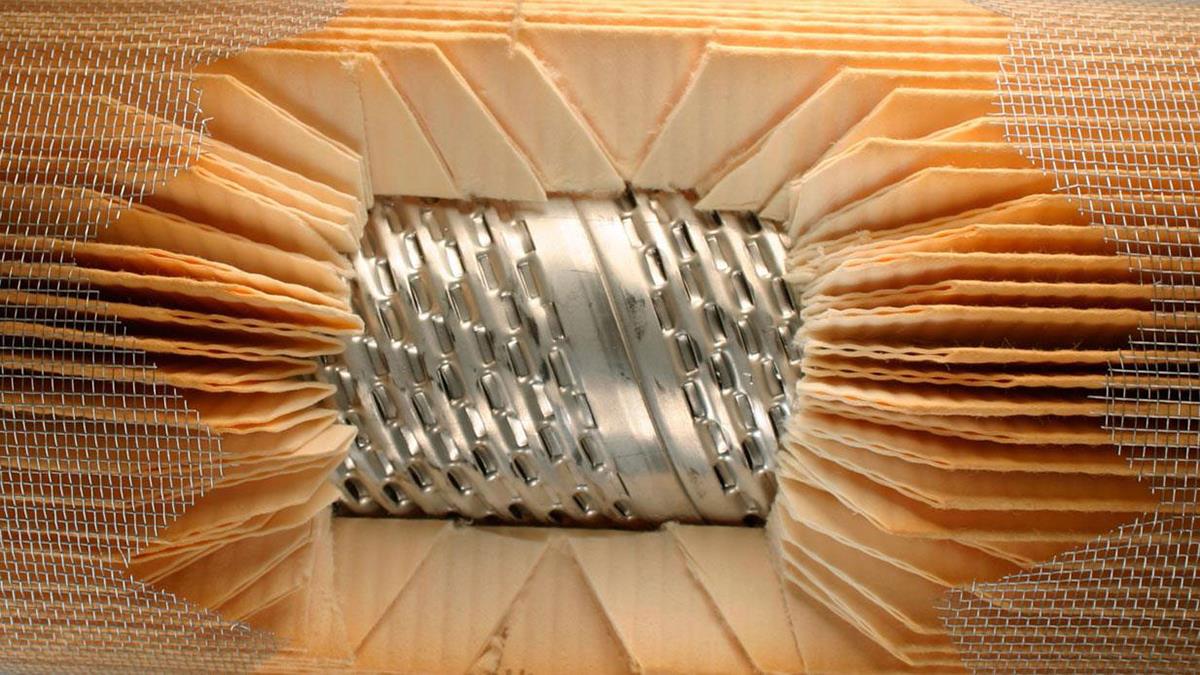

Oil filters can be characterized by the method in which the contaminants are filtered or the method in which the oil flows through the housing. One technique used to control contamination in filters is through surface-type media. This is the type of filter used in automobiles. In depth-type filters, the filter media are designed to hold much higher levels of contamination and provide a more circuitous path for lubricant contaminants to become trapped.
Other possible contamination control methods include magnetic and centrifugal filtration. Magnetic filtration utilizes rare-earth magnets or electromagnets to attract and collect ferrous particles as the oil passes through a magnetic flux region. Centrifugal filtration works by integrating a rapidly rotating cylinder to produce a centrifugal force for contamination separation from the oil.
Oil filters can also be categorized by the oil flow design. As its name implies, a full-flow filter will draw all of the oil through the filter media. On the other hand, a bypass filter only requires a fraction of the oil flow for sufficient flow rates within the system. The application’s oil flow and contamination control requirements will determine which design is the best option. Another alternative is the duplex filter system, which contains two side-by-side filters in parallel to allow one of the filters to be replaced during uninterrupted operation.
With typical canister-type filters, it is standard for oil to flow from the outside in. This means that the oil travels through the cylindrical filter media from the outward-facing surface into the inner core. However, in some cases the flow direction is reversed, with the oil coming into the filter through the core and pushed outward through a unique pleat design. This is intended to improve flow handling and distribution as well as reduce filter element size.

Filter Media Types and Dirt-Holding Capacity
In the September-October 2012 issue of Machinery Lubrication, Wes Cash explained how the porosity of the filter media plays a role in how well the filter can retain captured particles. This is known as the dirt-holding capacity. As pore size goes down, to maintain a low differential pressure across the media, the pore density must go up to account for the oil volume in contact with the surface. The filter depth and size also influence the dirt-holding capacity. Another factor is the filter media material. There are three primary types of filter media:
- Cellulose - Comprised of wood pulp with large fibers and an inconsistent pore size.
- Fiberglass (Synthetic) - Comprised of smaller, man-made glass fibers with a more consistent pore size.
- Composite - Comprised of a combination of cellulose and fiberglass material.
Cellulose media are advantageous because they can absorb some water contamination. However, these types of media tend to fail more rapidly than synthetic media in acidic and harsh oil conditions. Nevertheless, the primary reason synthetic filter media are preferred is their more consistent porosity and smaller fiber size, which contributes to higher dirt-holding capacity and longevity of the filter.
