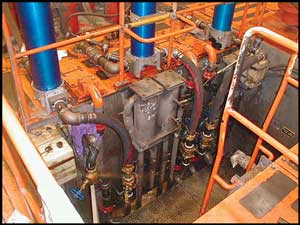

EVTAC is one of the smallest of six active taconite mines on northern Minnesota’s Iron Range. The EVTAC facility is a comparatively small open pit mine operation and employs three drills, two large 18 cubic yard loaders, four 23-cubic yard shovels and ten, 240-ton haul trucks to excavate and transport the raw materials to the plant. Unlike many of the other mines, EVTAC has made a break from the tradition of using electrically powered shovels and is instead relying on hydraulically powered machines. These shovels use twin 900-horsepower diesel engines to drive multiple hydraulic pumps, which in turn power the machine.
Each hydraulic system is extremely complicated and component intense. The major components of the system include a 1,000-gallon tank, seven main cylinders, 10 hydraulic pumps and several drive units. In all, the total system capacity is roughly 1,500 gallons and the system uses an ISO 46 hydraulic fluid. With only four active shovels, the loss of an hydraulic system can cut production by as much as 25 percent, making this system one of the most critical pieces in the whole mine site.
