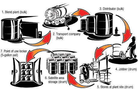

People have often questioned, for instance, how a lubricant with an ISO 15/13/11 cleanliness at the spigot of the blend plant can arrive at the machine weeks later so contaminated that it exceeds that maximum particle concentration measurable without dilution.
As an example of how particle growth occurs, let’s take a common R&O oil through the chain of custody from blend plant to point of use. See diagram.
Although neglect is a common reason lubricant quality can be compromised, a larger, more fundamental problem rests on the general misconception that lubricants are already adequately protected by storage and handling.
Others have said yes, that they can become contaminated and quality breached, but falsely believe the practical effect on lubricant performance and machine reliability is negligible.
ISO Cleanliness of Lubricants after Chain of Custody
