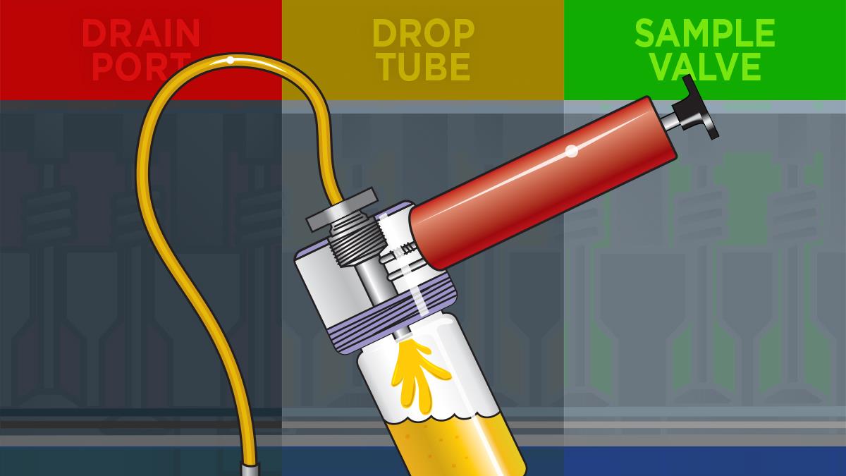

Besides drain sampling, another standard sampling method is drop-tube sampling. Here, technicians open their equipment, insert tubing, and suction out the oil with a vacuum pump. It's simple and low-cost. However, it does not always lead to the most reliable oil samples. Due to the nature of flexible tubing and internal obstacles within the machine, inserting the tubing into the same spot and at the same depth consistently is challenging.
Western University conducted a study to investigate the inconsistencies of drop-tube sampling results. Three sampling methods were used to draw oil samples from the same piece of machinery for one week:
  1. Method A (Push-button sampling valve)
  2. Method B (Sampling valve with tube)
  3. Method C (Drop-tube and vacuum pump)
They found that “Method A would be preferred over Method C because Method C has high variability in measurements (or resampling Method A has the least variability in particle counts). In addition, Method C gave a wide result of particle counts when resampled.” In total, drop-tube sampling can produce false negative sample results, harming an oil analysis program.
Consider this scenario: A key production line has slowed, and the gearbox is noisy. An oil sample is taken using the drop-tube method; the oil analysis report returns with no problems indicated. Nothing was done, and a complete failure occurred because the company missed the chance to replace a seal on the axle. This is what the cost comparison looked like:
Note: These figures are estimates based on customer cases and are intended for demonstration only. Costs may vary.
These sample results occurred because the sample was taken from the top of the oil level, where the cleanest oil resides, not near the “active zone.”

The best method for reliable oil samples is dedicated oil sampling valves, which minimize the data disturbances from other sampling methods. Sampling valves help obtain reliable, convenient, safe, and quick oil samples from a system, making it possible to take oil samples from running machines safely while reducing the chance of introducing contaminants to the sample or machine.
